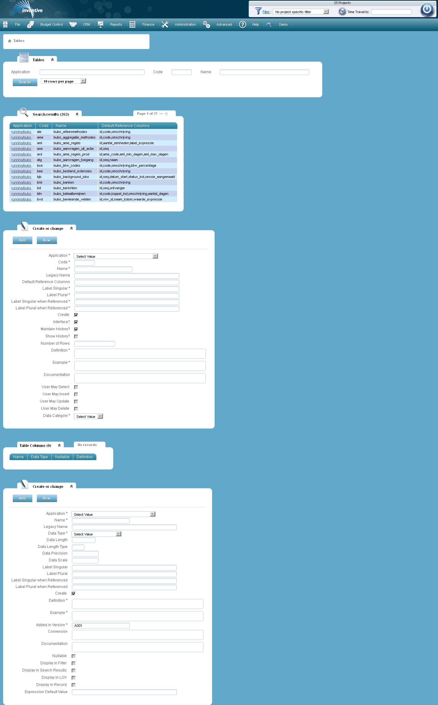

In this screen you can register and change tables.Open screen in browser ;8714;8825
Tables Screen
The meaning of the entry fields for a table is:
Application
The application of which the table is part.
The code with which is refered to the table. Usually, three-letter codes are used.
Name
The name of the table.
Legacy Name
The name of the table in an earlier stage.
Default Reference Columns
By default all reference columns from the table are included. If you would like you can include an other list of columns. Then, the reference columns are not included.
If you use a ‘+’ in the list of reference columns, all reference columns of the table will be included.
Label singular
The label of the table if the data is used in singular, for example 'Project'. It is also possible to use resources.
Label Plural
The label of the table if the data is used in plural, for example 'Projects'. It is also possible to use resources.
Label Singular when Referenced
Reference to resource if the data is used in singular.
Label plural when Referenced
Reference to resource if the data is used in plural.
Create
Checked in case the index must be included in the database.
Interface?
The table can be accessed via the web user interface if checked.
Maintain History?
The history of the table will be maintained if checked.
Show History
The history will be displayed if checked.
Number of Rows
The number of rows of the table.
Definition
Definition of the data visible in the table.
Example
An example of the data in the table.
Documentation
Documention about the table.
User May Select
Checked in case the application user is allowed to read data from this table.
User May Insert
Checked in case the application user is allowed to add data to this table.
User May Update
Checked in case the application user is allowed to update data from this table.
User May Delete
Checked in case the application user is allowed to delete data from this table.
Data Category
Data category of the table.
The meaning of the entry fields for a table column is:
Application
The application of which the column is part of.
Name
The name of the column.
Legacy Name
The name of the column in an earlier stage.
Data Type
The column data type.
Data Length
The maximum length of the data type.
Data Length Type
The data length type
Data Precision
The maximum number of digits in a number for a numeric data type.
Data Scale
The number of decimal places in a number.
Label singular
The label of the column if the data is used in singular.
Label Plural
The label of the column if the data is used in plural.
Create
Checked in case the column is included in the database.
Definition
Definition of the data visible in the column.
Example
An example of the data in the column.
Add Purchase Order
Here you can indicate the sequence of the column in the table.
Conversion
Possible conversion applied to the data in the column.
Documentation
Documention concerning the column.
Nullable
The column does not need to contain a value if checked.
Show in search filter
The values ​​of the column are displayed in the search filter if checked.
Show in search results
The values ​​of the column are displayed in the search results if checked.
Show in value list
The values ​​of the column are displayed in a list of values if checked.
Show in record
The values ​​of the column are displayed in a record if checked.
Expression Default Value
